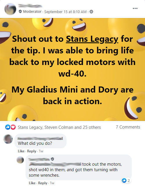

@paule I was navigating through the Gladius Facebook Group, one Mini owner was able to use some WD-40 and then turned them with a wrench. Now I know most don't recommend WD-40 for maintenance lubrication, but for this purpose I guess it works when the underwater drone motors are seized up.
