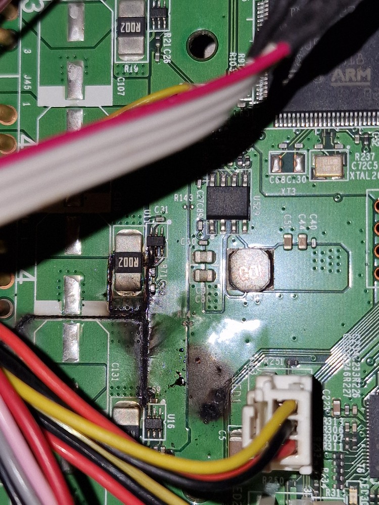

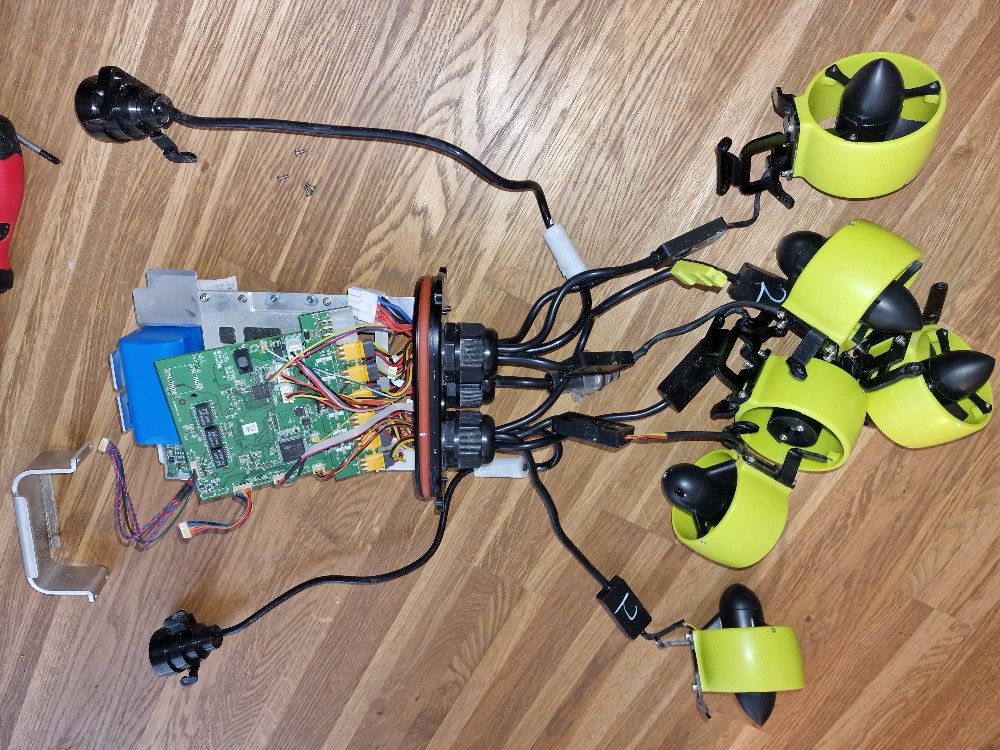

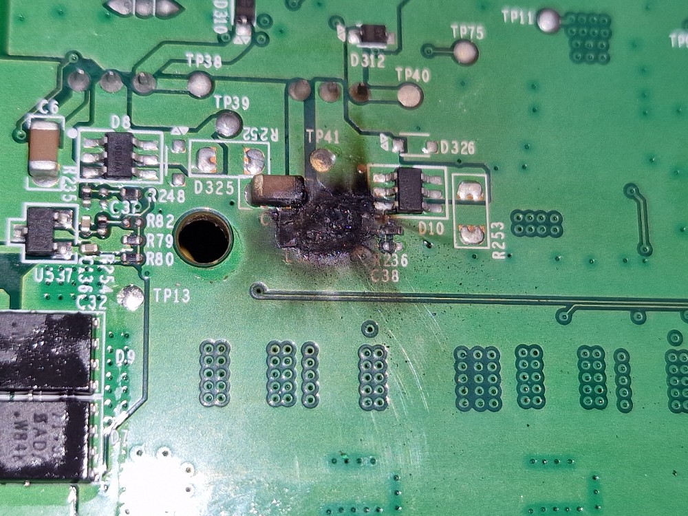

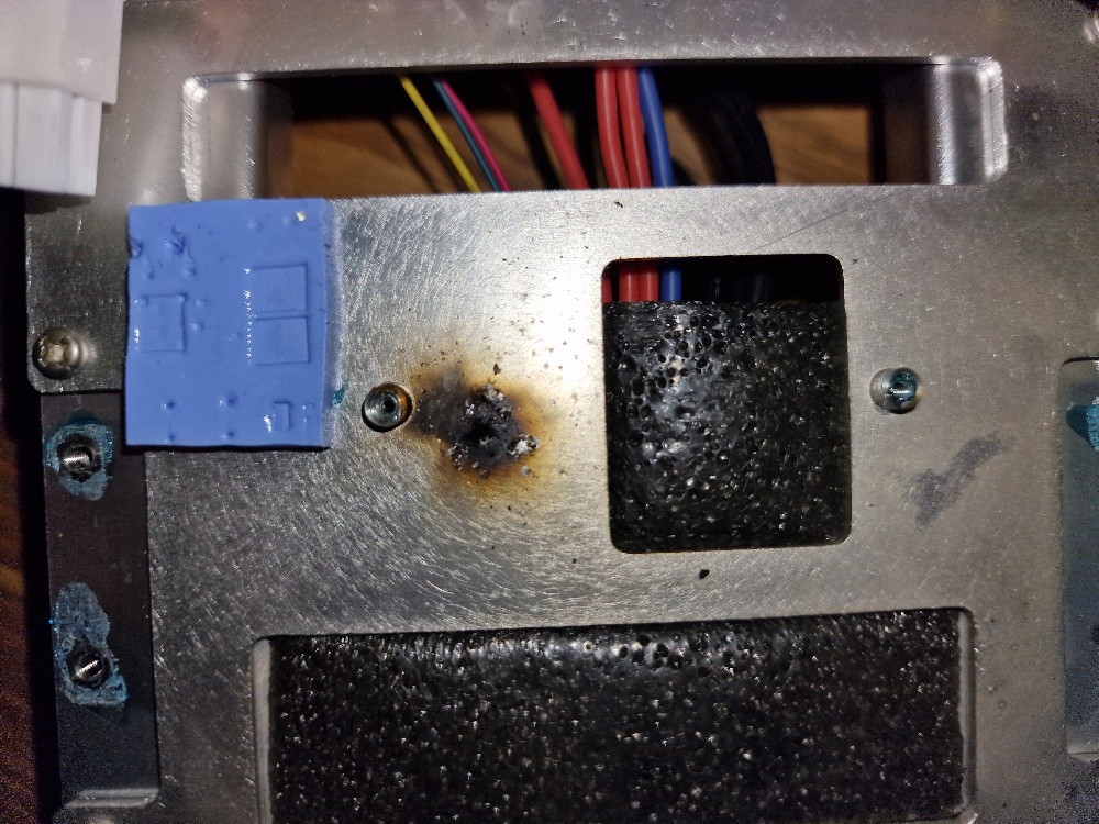

I have the same situation. The new drone swam for only an hour and then shut down. I pulled through and missed the warranty as it was hard and painful to send out.
Today I disassembled the drone (a real quest), and yes, the hole is scorched on the motherboard.
Found a new motherboard only in the US, thinking to order one.
Have you bought a new board?
Do you have more pics inside fifish v6? (foto battery and other).

I bougth a new board and got it in may only. Because it's available in US only and they don't ship it abroad. It works now with two limitations:
- there is no temperature and depth overlay on videos. But you can see them in the app.
- I can't download big files from the drone, i.e. 3GB and more
