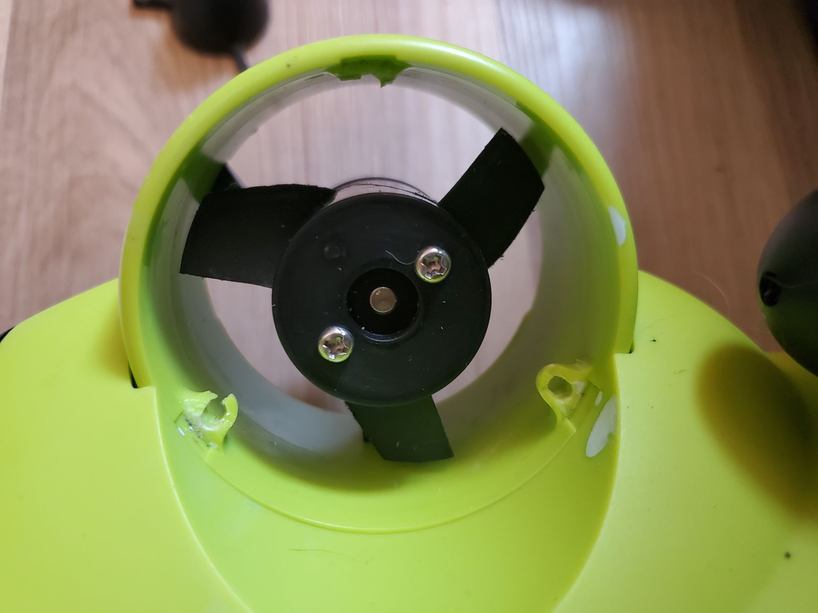

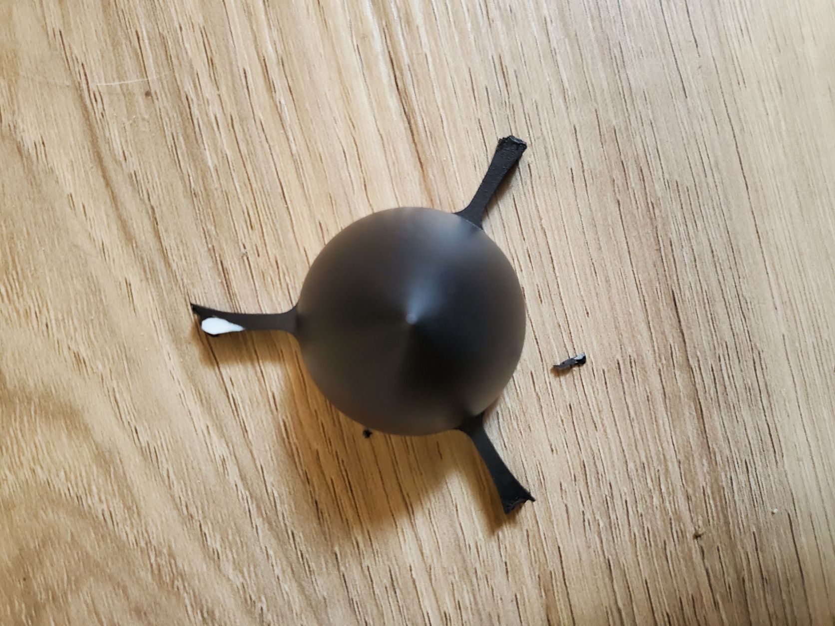

I was checking propeller orientation on the V6 and when removing the propeller protector, the plastic that attached the protector to the thruster completely deteriorated. The drone is only a year old, and has only been used in fresh (albeit cold) water, and was maintained as per recommendations. Has any one else had these issues?

So follow up-since it not under warranty anymore, and I needed a quick fix, I used Plastic Weld to attach the propeller protectors to the thruster housing-just testing it now (doing the motor maintenance in my tub in case I had to rescue it in a hurry) and seems to be holding up. I will be taking it out into more open water for a test swim later today. This is just a temporary fix until I can get the proper parts, but a good FYI in case anyone else has problems with cracking or broken plastic

This is my first post on this forum. I had some very bad issues with deteriorating plastic on my V6S. Since I still have a case with QYSEA I won't tell many details at this point. (They are very helpful, I have to add.) All I will say is: Don't Ever Use Loctite on Plastics!! At least not the blue (#243) and purple (#222) types. Unfortunately, QYSEA recommends #222 in some videos. This might have caused problems for some. QYSEA will revise their instructions. I don't know if use of Loctite explains Sonnenep's particular problem, though.
