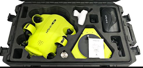

I unscrewed the cover underneath to check on the salt water buoyancy compensator weight and there isn't one. There was no mention of one in the instructions and I've just searched the box again, no weight.
So I suspect my problem is simply that it's sitting too high in salt water without the weight, exposing the tops of the thrusters.
It's front/centre in this pic from the QYSEA website - I'll go back to the guys I bought it off tomorrow and ask ;
EDIT - they may have done away with it, this QYSEA unboxing video of a V6 in Sept 2019 calls it a 'seawater module' but the cover described in my v1.4 quick start manual is called a 'mounting port' and has three screws whereas the older v1.2 quick start showed a two screw cover (consistent with the cutouts in the weight in the photo) and describesdit as the 'Fresh/Sea Water Module' (cover). So maybe later models dropped it, which means mine will probably be happier in sea water when my substantial looking lighting mount bracket arrives and I hang something off it.

Hi, I was talking to the NZ agent for these who was involved with the initial prototypes of the V6 and did a lot of field testing of the first units back in early 2019.
They said that "the initial production runs of the v6 had these weights, but they stopped supplying them on the 3rd production run back in 2019. They were not needed. Their initial intention was to adjust the weight for using the v6 in fresh water or salt water" before agreeing that it was "better to be positively buoyant in these scenarios for recovery purposes if the v6 were to die... they then started using this as the 'accessories port' after that".
That made sense to me when I really thought about dragging a dead drone backwards over everything on the bottom :)
